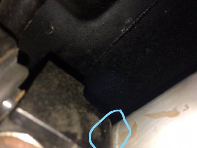

Thread revival!
It has been a while but with a delay from DSS as they were on back order then waiting for the container to arrive here in the UK I finaly dropped my car off with my mechanic last night for him to fit the prop shaft today,that is as far as it got as he hit a big snag!
The bottom of the gear linkage catches on the shaft! :angry1:
The part circled in this photo is the offending item! (that along with a screw/rivet on the shaft right where it meets said item)

Ok, after a little bit of research the part circled is indeed what Saleen fit to the stock linkage to shorten the throw, also found an old post on a forum saying to NOT install the Saleen short shifter block if running an after market drive shaft as it fouls!
Unless anyone has a work around I guess I will get my mechanic to remove the SS block and revert it back to standard throw.

Bummer!! How much does it hit by? How much does something have to move to make it clear?

I have an FRPP driveshaft, blowfish shifter bracket, and a UPR billet shifter. I don't have interference problems. Also my car rides on stock springs so my rear axle is farther from the floor boards and transmission tunnel. And I have BMR motor mounts spaced a little higher so my shorty headers clear the steering shaft.
I think and hope a different shifter would solve your problems. Unfortunately I don't see a fast and easy solution for you. It's gonna be difficult if not impossible to get different measurements on all of the aftermarket shifter's out there so you can find the shortest one and then order it. Maybe you can call/email each manufacturer and ask for specs to compare and find the shortest one. Good luck with that.
Or maybe, just maybe, you can mount the transmission just a little lower by trimming the transmission mount bushing. Or raise the engine just a little bit which will lower the angle of the transmission and driveshaft. There are a few different things you can change that will hopefully fix your clearance problem.
Think about it like this. If you put the car on jackstands and let the rear axle droop like your changing the tires, I bet you solve your clearance problem. Kinda like cutting your bump stops when you install lowering springs.
With the car in neutral and the rear wheels lifted they wont turn!
You should be able to see how close it is in the following photo, there is also as I mentioned before a screw or a rivet on the drive shaft which catches on thus preventing it turning.

Without seeing the rivet, I’m guessing it’s there to balance the DS, so there’s not much you can do with that. I have an auto. Is there a way you can shim the shifter to raise it? Put washers between trans mount and body to lower back of trans? Is the part of the shifter something that can be grounded off?
