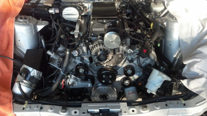

Seems like you are already set on rebuild and boost. This will be a lot more work and aggravation than most guys think. So start planning ahead. Who is going to build the engine? Are they reliable? Will they meet timelines and cost estimates? As for boost, I'd recommend getting a system from DOB. Who will be your tuner? Will he be reliable and available and provide updates as you run across drivability issues?
I did all my own work except for the short block and tuning (although I did collect a lot of data for the tuners) and it took years to get it all sorted out. Its not as easy as the internet makes it sound. I've got a stroker 302 3V, kenne bell, t56 and not one piece of stock suspension left. Plus 3 different throttle bodies, a couple clutches, 3 different tuners, 2 sets of injectors, fuel system upgrades, cooling and a lot more. If you are going to pay someone to do everything, it will get very expensive. That's how you spend 75k.
It was a ton of work but the car is wicked. I run high speed autox and over one 3 year span, I won everything that I entered. There is no way that the car would be like it is if I had to rely on some shop to do everything.
My main advice is be realistic. Its way harder, more expensive and much much more time consuming than it seems up front.

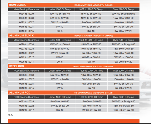

Here is a chart I found provided below & have been using for approx 2 1\2 yrs to determine\judge the proper oil viscosity to run according to the known\perceived new\current engine bearing oil clearances by Driven Racing Oils Co (manufacturing high performance racing oils for high performance racing engines) as oil viscosities play a far more important role in engine performance AND engine reliability by properly supporting the crankshaft within the crank journal bearings to maintain as true a line bore center as possible to maintain crankshaft stresses under loads to a minimum, reducing friction so crank can spin as freely as it can under pressurized oil feed AND to reduce as much stress as possible on con rods, con rod bearings & crank journals to maintain as much reliability as possible so a racer can get more than 1 pass out of a high HP\TQ racing engine to reduce the costs of rebuilds..............so they follow this chart religiously......developed from thousands of hours formulations, lab testing & real world testing to know what works best for the application.
From looking at the given new bearing clearances given by Ford of this 4.6L 3V V8 & the normal oil operating temps incurred (up to 160*F), the specs according to this sheet is 0W-20, 5W-20 when the engine is new..........if you put any extra operating temp into the oil to get it above the 200*F mark, the specs call for 5W-30 or 10W-30 according to this chart.........mind you, this is using new bearing clearances of a new 4.6L 3V V8 coming off the showroom floor......running on an OEM tune calibration..........
Hope this can be of use to others........................

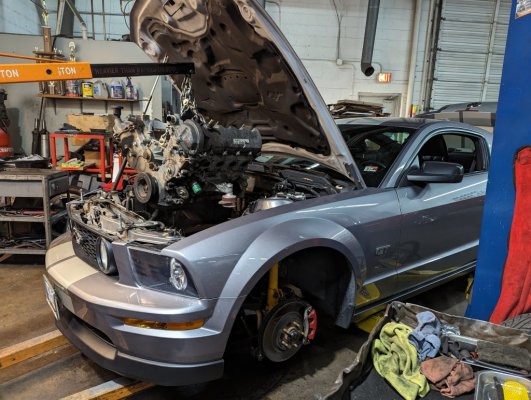

Dropped it off on Friday morning, stopped by the shop Saturday morning and got there just in time to see a motorectomy.

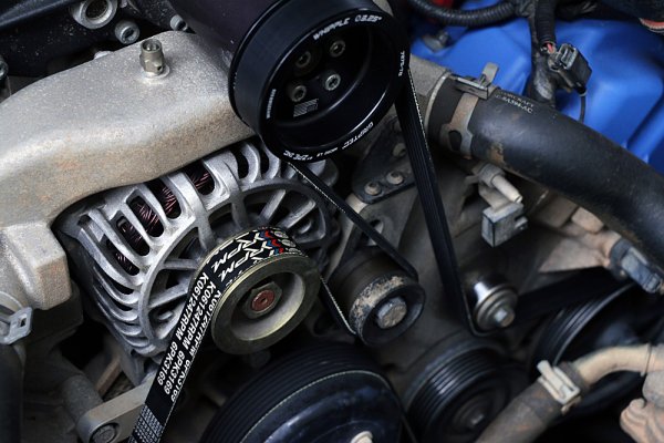

Get oem idlers or stake the inside lip so the pulley can't fly off the bearing! I ended up getting an oem idler after this happened and my 100mm idler from whipple didn't have a lip on the inside edge so i staked that mother after changing the bearing just like you would a castle nut on an AR-15. I had removed the 100mm idler to run the rpm belt and got a cheap 90mm off rockauto. that idler is still rolling down hwy 441 in north central florida. steeda motor mounts are weird. So if you need to lift the motor up you have to unbolt the motor mount from the frame or it will fall apart?idlergone.jpg

Been a little overdue for an update. Engine shop finally got the engine torn down, got a list of parts together and sent me an invoice for the next $$$ installment so they can order them. The parts list is growing (as is the bill... surprise) Total list now includes:

As they went through it they said they saw enough wear on the bearings and the valve guides to make it a wise choice to replace all that now. An extra $400 (valve guides are expensive apparently) is a small price to pay in the scope of the work here to get another 100k out of this block.
Talked to the main shop and we're going to pull the trigger on the valve covers and the ATI balancer. They have a few other items they're looking into that they want to run by me.
