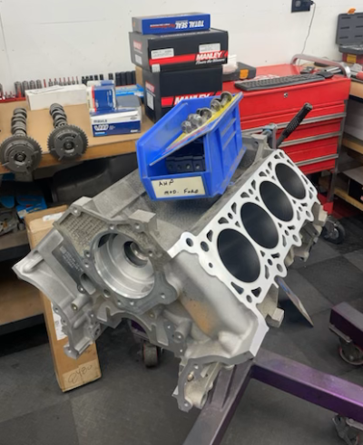

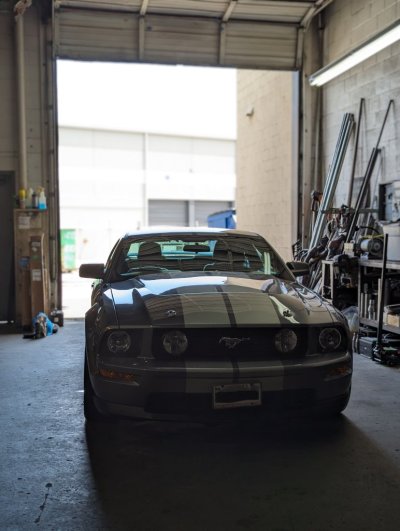

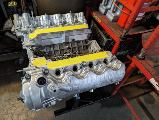

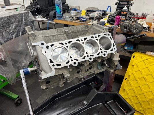

Maybe progress is going faster than we both thought. The owner of the performance shop sent me an email, he was visiting the machine shop and my engine's being assembled now (short block machined and fully assembled, rest of assembly continues this week). Machine shop said it could be ready for pickup on Saturday, and if that holds, then they could be installing the engine on the Tuesday the 14th.
Seemed like it was a lot of draaaaaaaagging on and on like this was going to take till the fall, and both me and the performance shop were in limbo. Now all of a sudden the machine shop is almost done. the lack of transparency on the part of the machine shop kinda pisses me off. Got a lot of questions out to the performance shop about where we are w/ the valve covers, harmonic balancer, and various other little things that need to be done before the engine goes back in.

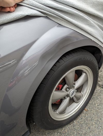

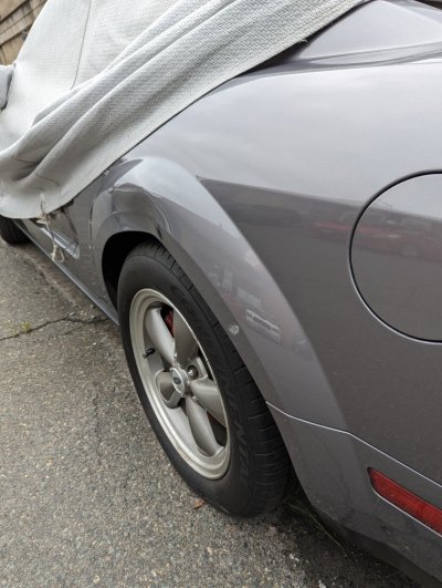

Well aint it fun....
Was stopping by the shop this afternoon and noticed a small tear in the car cover. Out of OCD, I went ahead and checked under the cover, maybe...it's fine....ok ok .... just in case....
GODDAAAAAMNIT.
I went in and told them about it, they came out looked at with me and said they'd take care of it. They've got a security camera right in front too so they say they can probably figure out who dunnit too. No doubt whatever scumbag did it felt they hit it too.
At least the paint isn't scratched (cover probably saved it) and there aren't any creases in the metal. I'm hopeful paintless dent repair will be able to get this out. I've seen some pretty gnarly stuff online get pulled out.

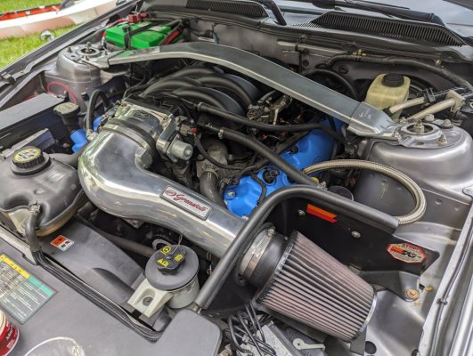

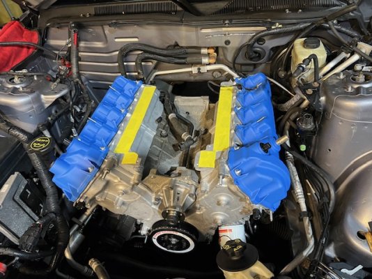

Unrelated to the dent, they got the blue powdercoated valve covers in and yes they are b-e-a-utiful. Wish I'd gotten them years ago. Now how to keep them clean?

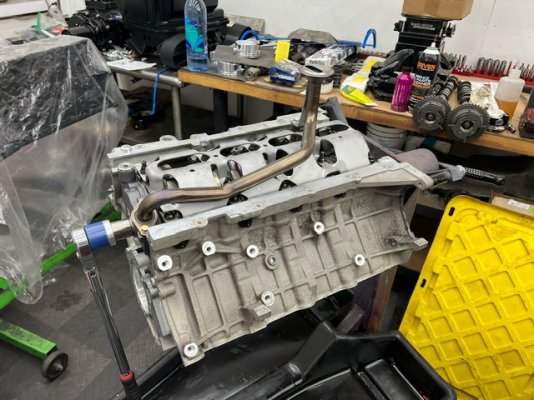

Been a busy week!
I'll let the pictures do the talking:

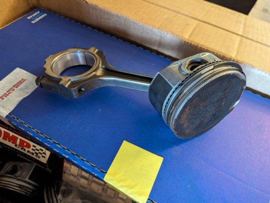

And at the last minute I asked them if they could get the original parts from the machine shop for my Wall of Pain, and sure enough got a nice box o' goodies:
What absolutely floors me is how small and light these pistons are. Kind of impressive what they can actually take when you think about it. I'll also get a pic of the cams later, you can definitely see which roller failed, there's a good 1/16th of an inch ground out of the lobe.

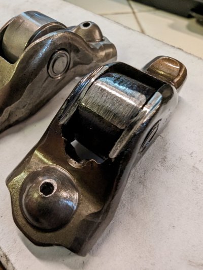

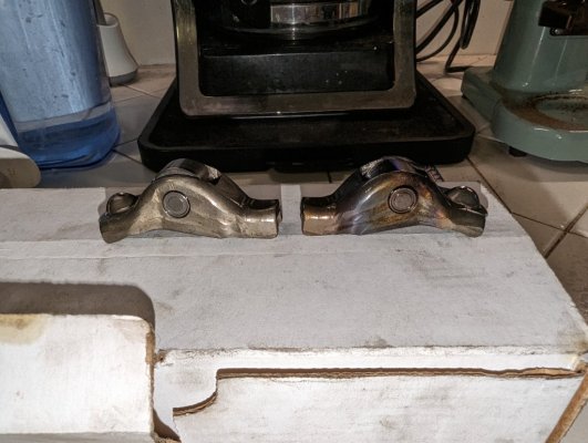

Speaking of oil, I was going through the box of takeoff parts, and found my $15,000 roller (at least that's what it cost me for the engine rebuild). Just look at the HEAT discoloration!
And here's the matching lobe on the cam. As mentioned way back in the original post, there were several lobes on this side that showed advanced wear, though this is the only outright failure. The driver's side looks pristine, BTW. Seems like an oiling issue on the passenger side

As far as how she's running, here's the first startup leaving the shop (they put 60 miles on her doing tuning, so not the actual 1st startup)
She runs great! The Comp Cams 127450's are definitely lopier than the 127400's, feels a lot like a cammed muscle car now (127400 had a very smooth, stock-like idle). Only issue is on cold startup, it wants to rev to 3000 RPM, so I've been having to use the clutch and brakes to hold those RPMs down for a couple seconds still it settles down. Messaged the shop about that, imagine they'll need to adjust the tune.
I haven't done any hard pulls (break in and all), but she seems like she's got more low end torque with these cams and the stock intake manifold back on. We're going to do a dyno pull after the break in so we'll see then how much of a difference it makes.
And speaking of clutch, while they had it apart they put in a McLeod RST. WAY lighter than the McLeod Street Pro I had, although the pickup point is also a lot higher on the pedal than before, and that's taking some getting used to. And the rattle! Under certain loads between 1500-2000 rpm, it sounds like an old jelopy. But reading up on it, that's pretty common with dual disc clutches. So I guess I'll have to adjust my driving habits and avoid that rpm range cruising around town
