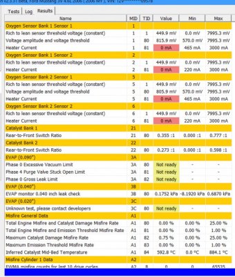

Here's the Catalyst Monitor test results from Torque after driving it ~ 40 min (10 min stop&go, 5 min highway, 15 min stop& go, 10 min idling)
MID:$21 TID:$80
- Catalyst Monitor Bank 1
Max: 0.77733Ratio Min: 0Ratio
Test result value: 0.35546Ratio
PASS
MID:$22 TID:$80
- Catalyst Monitor Bank 2
Max: 0.59765Ratio Min: 0Ratio
Test result value: 0.27343Ratio
PASS
I've also got the test results from FORscan in the screenshot

Appreciate you posting the info, cavero!
They're looking good to date & this data is helping me to know of what to expect from a set of these cats installed in my car's exhaust system if push comes to shove so I really am thankful for the postings.
Note: I wouldn't sweat over the Mode 6 O2 sensor data showing that all 4 NB O2 sensor's heater circuit voltage is at 0v (which is below the min allowed voltage threshold thus flagged in red instead of green) as this is most likely due to your engine's exhaust temp\temp created from catalyst operation being more than sufficient to maintain optimum operating temp for your NB O2 sensors to operate efficiently after initial warmup from cold start thus the PCM has opened the grounds in the heater circuits so no voltage is PWM modulated to ground (PCM also is showing no DTC's & O2 Sensors are OBDII Complete & Passed as well as the avg CMBT-cat mid-bed temp-reading for both cats in Mode 6 data under Misfire Monitor is fairly high @ 592.8*C or 1099.4*F so they're cooking pretty damn good). Since these are powered thru the same #45 PCM fuse in BEC that powers the VCT solenoids & EVAP CPV & CVS valves they most likely have +12v power thru them to the PCM (PCM reads the +12v at it's O2 sensor heater terminal pins when KOEO or KOER so it knows the circuits are good) as well but it wouldn't hurt to check to verify...……..I could be wrong on this.
Yours is the 1st I've seen this occur on the O2 sensor heater circuits. Most test results will show some actual O2 sensor heater voltage usage amount above the min heater voltage threshold being used but not exceeding the max threshold as the exhaust couldn't maintain the necessary O2 sensor operating temp w\o some help from the O2 sensor heater circuits...….
Just thought I'd mention this since I noted it thru your Torque\FORScan Mode 6 data.
