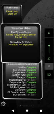

Got the car back today, passing all monitors :chewie: . Verified in Torque and the OBDLink app.
Going to try finding the Mode 06 in ForScan in the next couple days. Torque and OBDLink didn't show cat efficiency, closest it had was Catalyst monitof Bank 1 / Bank 2 and it was a ratio
