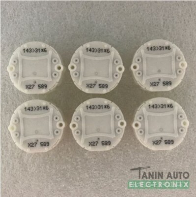

Replaced all 6 stepper motors, what are the odds i got new but broken ones?

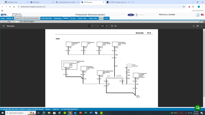

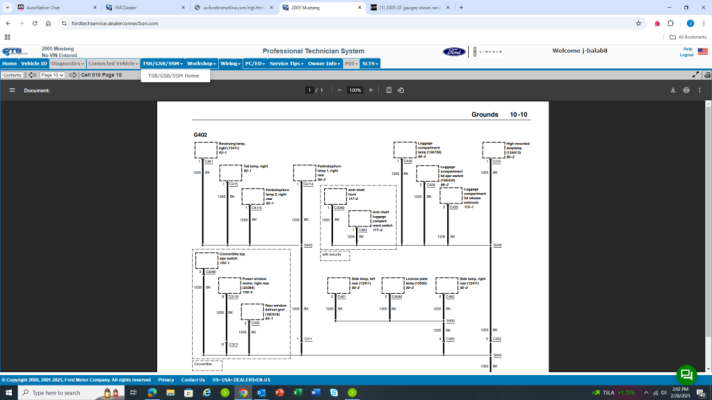

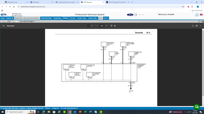

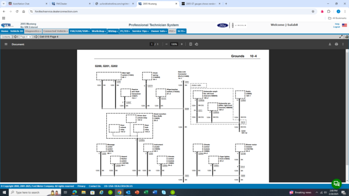

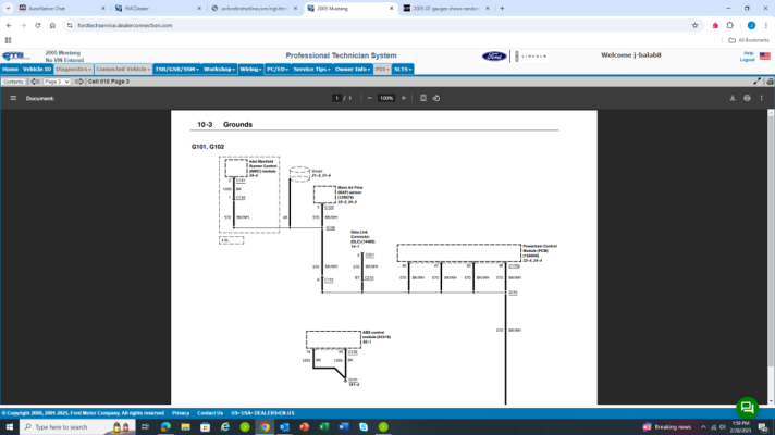

I'm sorry to hear you are having problems. I can't imagine that ALL the step motors went bad at the same time. That's absolutely silly. But, it seems you did fix some problems. You may have something else going on. Possibly grounding. And probably something else, as well.
Of course, I could be wrong.

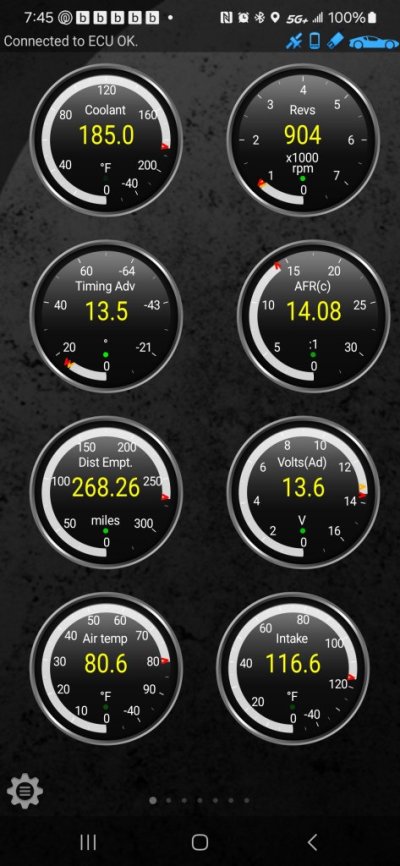

OBDII readers are cheap (I went with the Veepeak on Amazon for $20) and the Torque app is $5. Wealth of info is available, with just that...

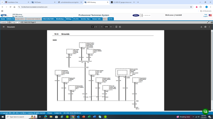

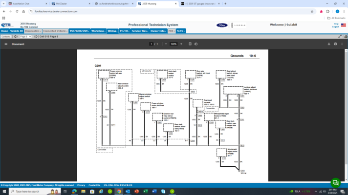

Finally i have it sorted! It seems to be related to my constant brake lights on, which was caused by burned microcontrollers on SJB. Replaced two of them, all problems are gone.
