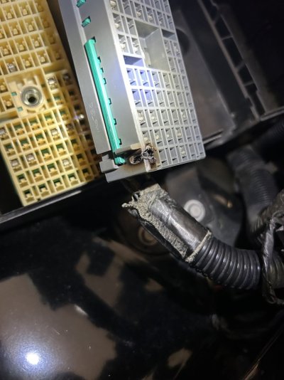

When you check the relays, you need to actually check the connections below the relay. I would separate the two halves of the box and inspect terminals. Sometimes it's hard to see the problem until you are right on top of it.

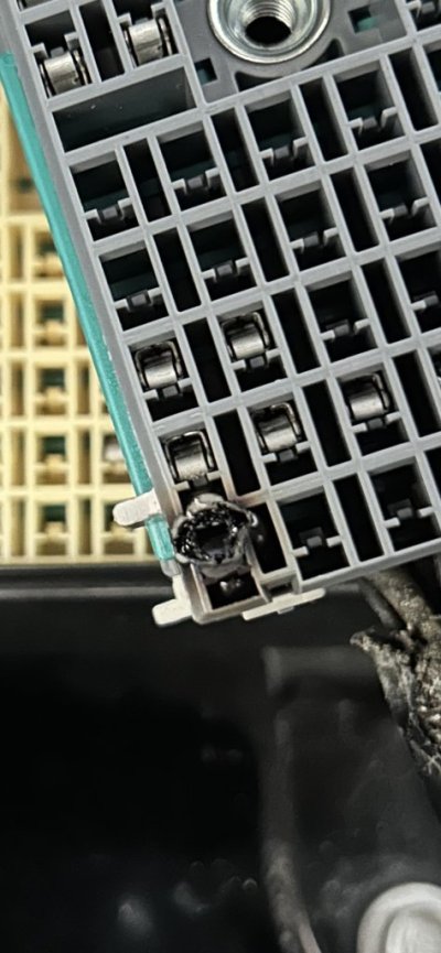

If you look under the fuses in the fuse box you might find the burned out terminals that power the two fan motor settings. Both of mine were fried and the high temp completely failed.
