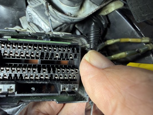

I received replacement PCM from Flagship programmed to my VIN. Lito supplied PATS programming. Hooked everything up and still have same problem. This is PCM connector with red plastic cover removed. I was not aware that came off. Circle is #25.
Before yesterday, in order to test for continuity, I had to use a piece of safety wire to fit in the small hole. This pushed pass the pin and touched wire making contact. With cover off, I can use probe from multimeter directly. I can also grab wire from behind. It fails the wiggle test. I believe the pin has a short, or broken wire.
How do I depin this, and is there a part number for the pin? I spent over an hour last night looking online. The only solution I found was going to a junk yard or buying used wire harnesses off EBay.

Check this video here for reference..............
Also, I highly recommend picking up a set of connector depinning tools (don't need to get the professional sets..........get the cheap sets usually strung together using a ball chain........) so you'll have them in hand to depin most any connector made........including Ford so good back up tool set to have......whether you have a jeweler's set of screwdrivers or picks in hand or not.
Brian covers most of the types of Ford connectors that are used on most Ford vehicles so you can get an idea of how to go about this.........but in the end practice will have to suffice........been there, done this myself.......have to finally figure it out where the inner locks are located within the connector body & what specific depin tool to use to unlatch it.
As for spare connector pins, your best source will be the Ford dealerships if no other source can be found...........just take a picture of the connector in question & where\what part\component it attaches to along w\ the usual vehicle ID info.........they should be able to get you the right replacement pins\pigtails for the connector.
Hope this helps.................
PS.........when you figure it out, please post your method as this specific Ford PCM connector I haven't had the task of depinning 1 at the moment. You also could hit up Matt Soppa @ Make It Modular for pointers as he regularly does this on the very connector you're looking to work on.

Thanks GlassTop. I had all ready ordered a kit of removal tools. I was hoping to find which one to use. I had a friend over today who raced and wrenched his whole life. He said this doesn’t make sense.
I have a Ford dealership very nearby and I’m going there tomorrow along with a service station that advertises electrical repairs. Hopefully Matt can offer some insight.
I will definitely post what happens. Maybe it can help MrPuffles too!

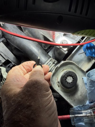

What a nightmare this has become.
Found the small, thin, pointed tool that worked to remove pin. If you look in the other photo into the empty holes. You can see small tab. The tool needs to be placed between pin and tab for pin to be removed. Look above connector to see thin blue wire and pin.
Here’s the nightmare, if I run a jumper wire from battery to PCM pin. I get a full 12.8V at the MAF pin. There is nothing wrong with this wire. For some reason, the pin is not making a good contact with PCM. The pin in PCM connector pulls out the front while the others do not. Something is wrong with pin or connector.
Matt@ Make It Modular did respond with model number for pin and place to buy. Thanks GlassTop. They come in strings of 100, so if anyone needs one in the future. I’ll have extras.
I tried to push pin and wire in from the back, but I don’t have the proper tool to reach. Of course it’s on the bottom under two other wire harnesses. I will tomorrow.
Lito said he has never heard of a PCM losing the 5V power supply. So having two PCM’s the same issue says odds are it’s not a power supply issue and it’s a connection issue.
