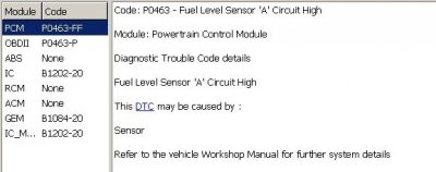

Crap!!! I took the Mustang out for a 20 mile drive today. Ran fine, no warning lights. I was interested in seeing if the P1000 code had disappeared (test complete?) so I hooked up ForScan and got this DTC report - pic attached.
Fuel gauge working normally, no issues that I can see. The only change from my test drive yesterday was when a driver pulled out in front of me and I hit the brakes hard and heard a loud 'thunk'. My first thought was that I had left a tool in the car and it had been thrown forward. I pulled over and looked inside, nothing there. Looked under the hood, nothing loose there. Drove home normally, still no issues. Fuel gauge working normally still.
I'm aware of the trunk lamp DTC; I removed the bulb weeks ago because the socket kept dropping down.
The fuel level sensor DTCs have me stumped. The tanks been full for a couple weeks (very little driving since fill-up). It does now show a slight decrease. The needle swings up when started. No visible leaks.
Anyone had this happen??? Panic-stop related, maybe???
Should I try to clear the codes???
Thanks in advance!

Just a follow-up to the above post. I decided to delete all the codes in the last scan, and when I deleted the P0463-FF DTC with Forscan, all the other DTCs went away. All that remains is the ubiquitous P1000 code.
Since then, I've put 61 miles and a dozens starts on the car. No warning lights, and no new codes.
I had planned a fuel filter and an oil change/filter next, but maybe I'll re-think those. I'm sure they'll give me multiple DTCs and probably a warning light or two. :(
(Still have no clue what that loud 'thunk' noise was...)
