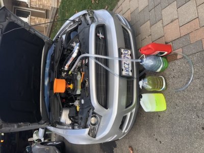

What I did was drive the car around for 20 minutes so the thermostat opened up, then I disconnected the hose from the degas bottle that comes from the water pump and had it go into an empty jug using a longer hose that I attached. Started the car and let the old antifreeze flow into the jug and filled the new antifreeze into degas bottle. Takes some time as you have to wait for the antifreeze to go down and pour more new stuff. Once you only see new stuff coming out of the water pump hose, it’s pretty much done.
