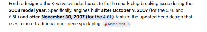

2019Chieftain, lots of good info in the thread below, & a 4.6L V8 built after 11/2007 (see door jam sticker) should have the 1-piece plugs, but I wouldn't let that dissuade me from a clean '06-'09...later '08-'09 even better...& I'd definitely prefer to change them myself, only took me 2 hrs, & you'd do a more thorough job than a dealer, making sure no grit or debris fell into the cylinder, proper torque spec, using nickel anti-seize, etc.
