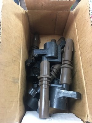

One thing I am unclear on is which plugs and coils I will need. I have uploaded a pic of the ones on the 09 block. Are these what I need or are there different ones I need to buy? If I need to buy different ones can you let me know what to look for specifically?

Hey Barry,
Attached pics are the Coils and the plugs I like to use. Send me a PM I have a spare set of Good OEM coils I used as backups, you look up what they are worth and give me half. I also have alot of used plugs that are perfect, I will send you 10 of them to get you going free. I use to change my plugs alot when testing on the dyno or track.
Don't use aftermarket coils, OEM only way to go. Also the plugs I'll give you are gaped real tight to like 20 due to the boost I ran. You will need to gap them back to stock.

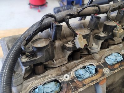

547D7530-37CD-45A8-8867-3BC614B6CE5A.jpeg I just went through this... putting a 2010 engine in my 07. Use the ECU and wiring harness from the 2007 to make your life easy. The only changes are the alternator power wire, which is very easy to enlarge the connector with a drill to fit the newer (larger) pole and the actuator plug on the back of the intake is different but the connector on the harness side is the same so it's a plug and play swap.

View attachment 81572 I just went through this... putting a 2010 engine in my 07. Use the ECU and wiring harness from the 2007 to make your life easy. The only changes are the alternator power wire, which is very easy to enlarge the connector with a drill to fit the newer (larger) pole and the actuator plug on the back of the intake is different but the connector on the harness side is the same so it's a plug and play swap.

Understand. I only did the swap out of necessity. I bought the car with the engine blown. Previous owner tried to install cams and dropped the valves on #5 cyl into the piston and didn't realize it until he started it. Not good... block had a hole in it... some folks need to stay away from youtube mechanics. :)
