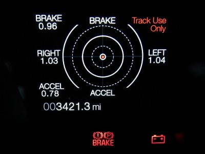

Accelerometer Mustang Convertible GT 2014:
Recorded (photographed) on 2015-07-27; figures produced a couple months earlier than that
Tires were near-new Michelin Pilot Super Sport 275-40x18 on SHELBY CS56 x9.5-inch ET 45mm wheels; otherwise, completely stock, as-delivered car. Asphalt parking lot at Qualcomm Stadium.
BRAKE was full-on, to anti-lock function; ACCEL was on a well-prepped launch pad at Barona (2.071 sixty-foot).
