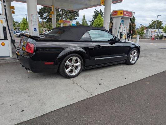

I have a 2008 GT convertible - California special package.
I had two questions I'm looking for input on:
1) I've heard there some extra complications of installing coil overs on a convertible, but can't seem to find any details or videos of what those are - anyone know of any or have any first hand experience?
2) knowing my goals for the project, what would you do differently?
The old girl has 130k on her and I think the suspension is tired and ready for a replacement. I'm planning on doing a coilovers kit, as I want to lower the car ~1 inch. I'm looking at the v1 SP performance kit on American muscle.
Goal for the build are to increase handling and reduce body roll, and a sportier look, while still being a comfortable daily driver. Being a convertible this is just a fun weekend cruiser, never going to see the track.
I'm going for some of the lower spring-rates so it's not too stiff, and I'm not planning on upgrading the sway bars as I don't plan to head to the track and don't see the need, but would love to hear others experience.
Pictures for fun....

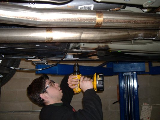

there is some extra bracing as Jeff mentioned above, I had BMR Subframes added to mine and this required modification of the factory braces, the factory braces you can see in these pics, worst case is you will have to remove/reinstall them but I don't think you will

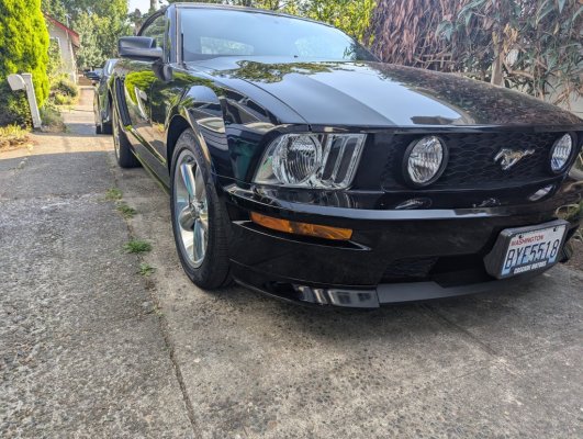

jonny -thanks for asking the question and also everyone for good responses.
Nice California Special it looks well taken care of.
I am on the same path as jonny.
I have an 08 GT Delux convertible and similar driving habits as jonny.
I just want better handling and a bit of a lowered look and some long distance comfort and the ability to drive on the peppered city streets here in Seattle to get out to the nice country roads.
I hope to accomplish a 1" lower as well.

I ended up going with:
SR performance coil overs from American muscle. I talked with one of the sales agents and these had lower spring rates than others models and would be better for daily driving. Probably overkill, but the ability for adjustment and Id like to think I could autocross it down the road and this would allow that. Also didn't want to mess with spring compressors for the install and i like to do my own wrenching when I can.
Adjustable pan hard bar, might as well while I'm at it
Adjustable camber bolts - recommended by the guy at American muscle to help with getting the wheels closer to stock alignment for daily driving and can always mess with the camber plates if I do go to the track.
Parts are on they're way, and planning to do the installation over Thanksgiving week!
Now just to get the the valve covers painted and new plugs and coils in before the next batch of parts arrive
