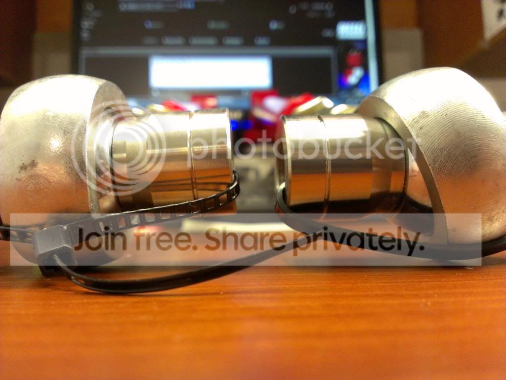

The "problem" with bearing on both ends is, you don't have a good way to control the control arm position, to keep the bearing "indexed". When you have bearings that are out of travel, bottoming out, they can be obnoxious.
Personally, I am a fan of a fixed style bushing on one end, and a bearing on the other. Rubber, Delrin, Poly, etc, as it will keep the bearing from making so much racket, AND it helps control contamination.
Left side is indexed, and how the bearing will typically be with a fixed style bushing on the opposite end. The right side, is how the bearing can/will be at any given time when running a bearing on both ends of a control arm (UCA/LCA).
Lack of proper bearing indexing, is without a doubt the #1 reason for complaints about excessive NVH with bearings.

1: I recommend this ALL the time. My recommendation is typically a little different than adding spacers, etc, though.
For a Rod-End like I pictured above, the "Seals It" rod-end boots have proven to be very successful in eliminating the clicking and odd noises from bottoming out the bearing. I recommend these pieces on a daily basis:
http://www.sealsit.com/rodendboots.asp
I only started recommending them after I thoroughly tested them in house. They are a booger to install on our parts with our SS Spacers you see pictured above, but they fit TIGHT and work well. When the rod-end bottoms out, it is cushioned quite well. The material Seals It uses is very impressive. I also like these because it can help soften the noise, if any....AND they help tremendously with contamination.
The problem with our housed spherical bearing pieces is.....I have to walk the customer through ways to avoid these occurrences....without the luxury of having a boot, or pre-made piece to simply send them a link to, for ordering.
This improper bearing indexing.....is mainly due to a loose jam nut, or DUAL bearing systems. Another reason why I like a fixed side, with a bearing on the other, in addition to the reasons in #2 below.
