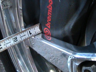

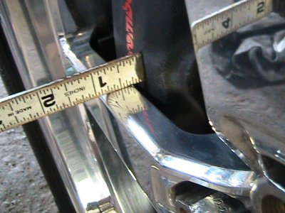

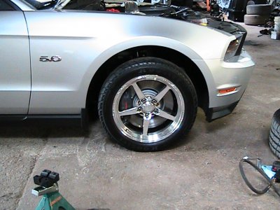

Alright, so I tried bolting up my 17x4 in Alumna stars with the Brembos. And as Im sure you could have guessed the calipers hit the wheels. After playing around it looks like a 13/16 spacer and extended front wheel studs are the only way they are gonna fit!
BTW the factory 19x9 Wheel and tire weigh 55 pounds.
The Alumna stars with a 26in radial tire weigh 29 pounds

Spacers will be on the end mill tommorrow. Done in time for wed night...

I wanted the wheels LOL! If it comes down to it Ill put the base Gt brakes on the front, But I think that it will look awesome if I can get the wheels to work.
