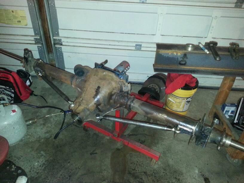

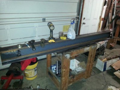

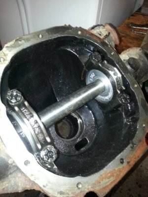

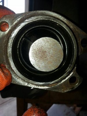

this is my buddies 89 gt axle. It was bent
bought an I beam to use to jack it around
I'm gonna weld mine next and jig it with braces and a 35 spline spool from moser with 9" big ends
