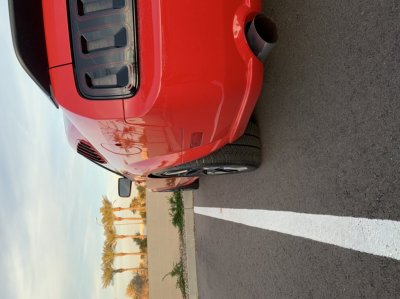

Got them on and man are they close but no rubbing!
It looks absolutely killer IMO.

Nice score & those do look super sexy on your ride!

Agree, very nice. Look sharp and really add to your color combo! Very nice looking '06!
