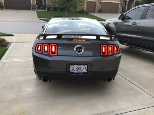

The taillights I have are from a 13 gt, not aftermarket. I miss understood, I thought that yours were stock. You might have to use a resistor.IMG_0115.jpeg

Got it from AM. The 13-14 taillights fit but there’s a gap at the bottom. The filler closes the gap and makes it look better. If you zoom in on the picture, you can see the filler. Especially on the passenger side, there’s a white dot.
