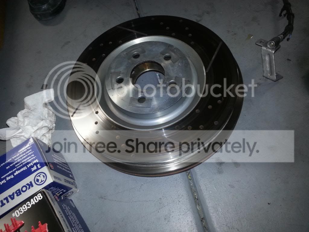

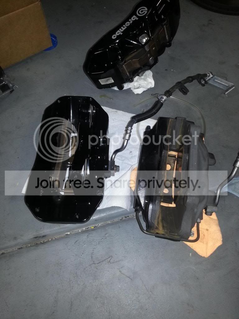

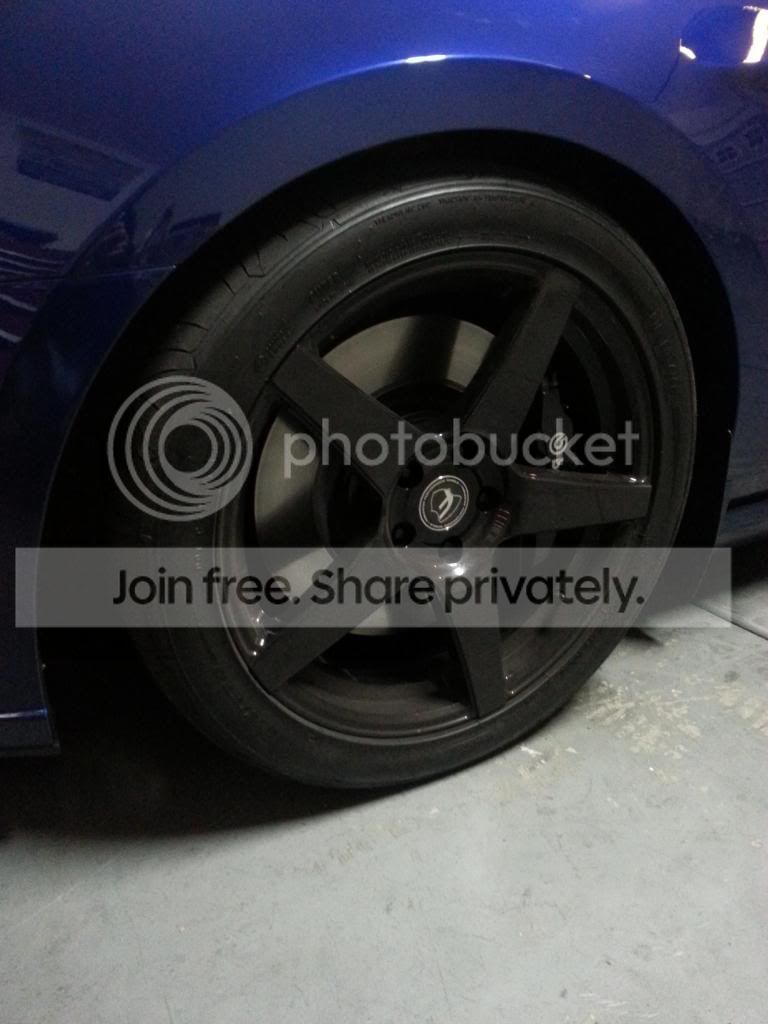

well I ended up getting them for $650, and I already sold my 4 pistons for $550 so I think I made out pretty good. They really fill out the wheels, and just look like they mean business. side by side they make the 4 pistons look like girls brakes lmao. Only thing is I don't think I bled them all the way. I dont know what I did wrong, I bled 3 32 oz bottles of fluid through them. They feel 80% of the way there, they stop the car good i even noticed improvement in high speed braking but if you jam the pedal hard it will go to the floor. I guess what I am trying to say is i want the pedal more firm, so I am assuming I need to bleed it more. Anybody have any tips for bleeding these brembos or the brake systems in general on these cars? do I need to bleed the rears too when I just changed the fronts? thanks!
4 vs 6 piston, the pad is much larger
14" vs 15"
crappy pic of them in my 19" forgestars
