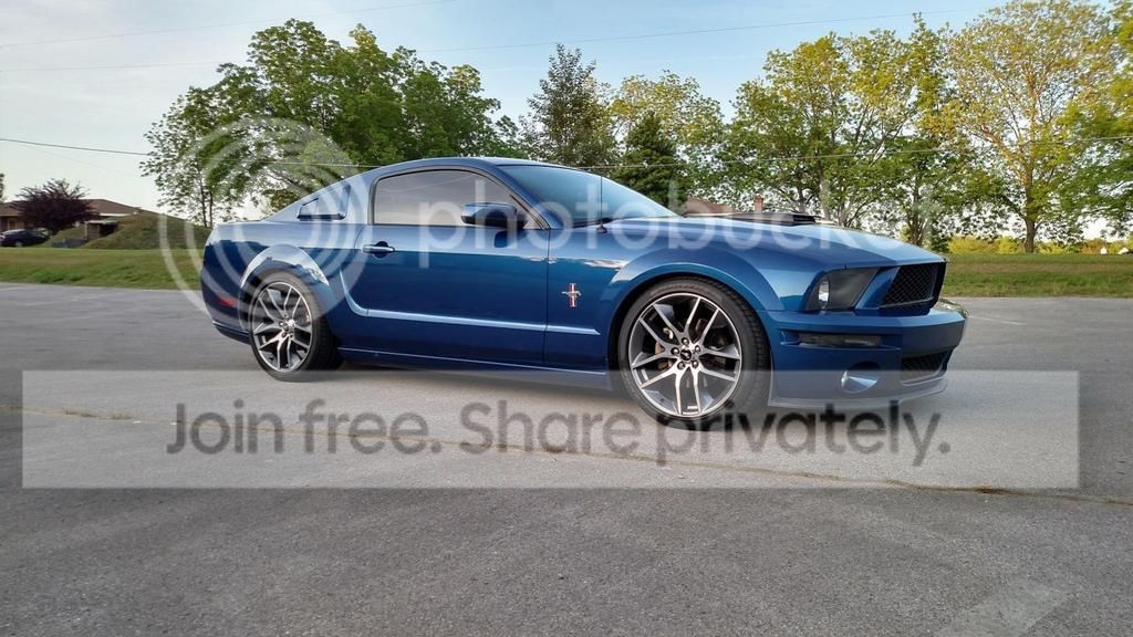

The only difference is the lug diameter and associated lug nut size. Went from SAE 1/2-20 to metric 14-1.50. Small difference but significant. Still 5x4.5, aka 5x114.7.
One member has a blue S197 with S550 wheels and has posted pics of it. Looked really nice. It's in the lowered on 20's thread. Post #2491
