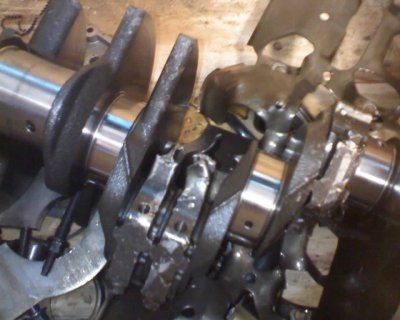

Hey Tony you got some new special rod design? I don't think you're gonna out run anyone with those rods! :thud:
