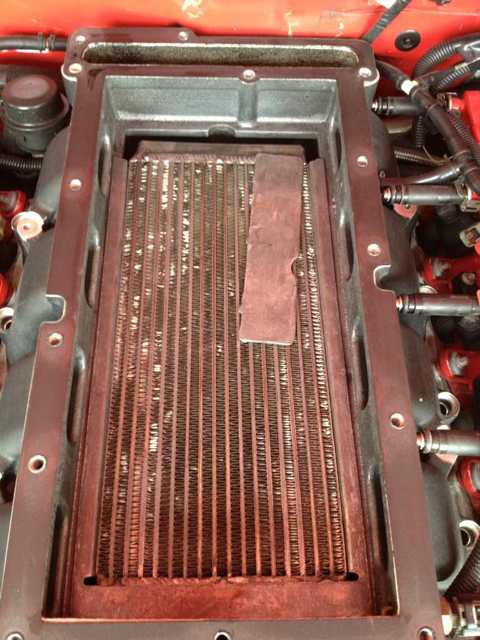

So, took the top off the S/C and I find this. Not the first time I've seen this as I know there's a thread or two around here about this and how to repair it.
Could this be the cause of my problem? Does this have an impact on airflow causing what I described on the first post?

Crap...Water from the inter cooler dropped down to the screws. Now I have to take the whole thing out, pull the screws, clean them and re-install.

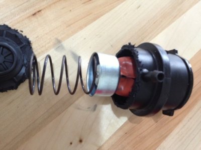

The bypass actuator, which is a year old is leaking. Hope the cause was the boost problem caused by the broken part of the intercooler. I have a new actuator on the shelf.

Well, all buttoned up and took her for a test drive. The acceleration problem did not surface, although it didn't do it all the time anyway, so I'll keep testing it this week.
One thing I definitely noticed is that it goes into boost a hell of a lot faster. I only ran it up to 10 psi of boost, but it smacked me against the back of my seat in a hurry.
Keeping my fingers crossed that this was the problem.

Well, the actuator wasn't crushed but certainly ripped. Same thing that happened to the other one I replaced a year ago.
