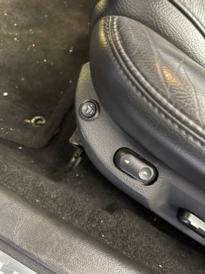

frank4x4
Aug 6, 2012
I put mine in years ago. Put the high and low switch on the front corners of the seat side skirts. And don't bother getting new hog clips just use big zip ties.

Thank you for the picture, looks nice. I ordered a pair from Check Corp in Michigan. They told me they're currently having material supply issues, which doesn't surprise me, and it could be weeks before they'll have them available. I'm not in a hurry, but am looking forward to getting them installed. The remote trunk release project was last week, along with changing the plugs, this coming week is installing a junk yard GM mirror with temp and compass.
