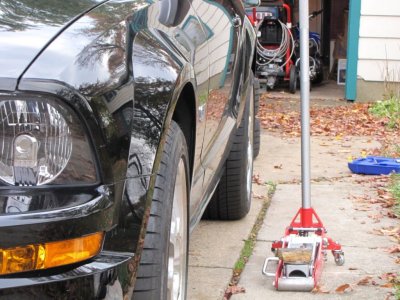

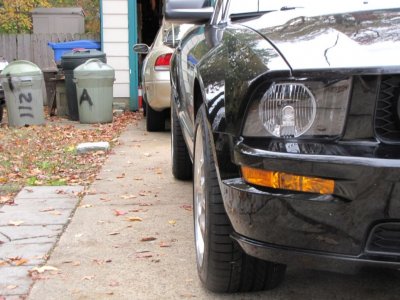

I've never noticed that on my car. Then again, my car is sitting at OE ride height in these pictures and was something of an outlier in some other aspect of suspension.
These are the best available pictures. 265/40-18 tires on 18x9.5 ET+45 GT500 wheels. My eyes can't see any difference.
