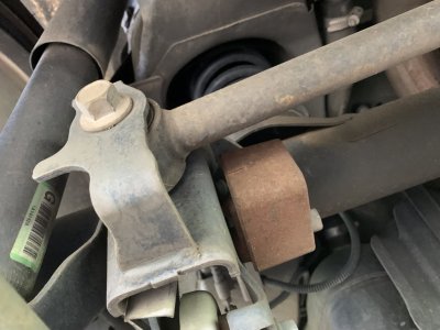

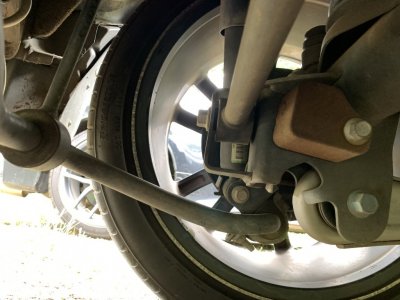

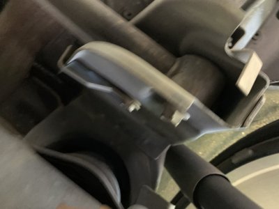

No, it’s stock height. I managed to get under the car (even though it wasn’t raised) and took a lot of pics. I couldn’t see anything that looked bent/scraped/or damaged. I’m beginning to think the offset has been there all along and just went unscrutinized until now.
Attached are some of the pics…

Nothing jumps out in those pics.
Mine was off center at stock height too. It does not look obvious till you add wider rear wheels.
