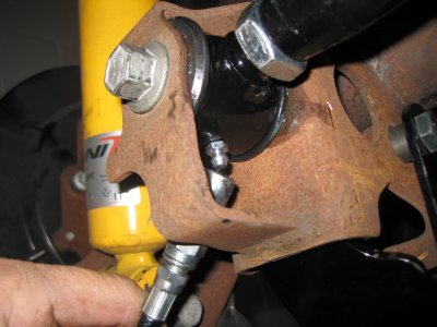

You don't have a problem yet, except maybe in your head. I had an aftermarket cover but not finned. It had reinforcements for the carrier bearings for hard launches. My BMR panhard bar fit just fine without the relocation bracket.
You may need to swap the grease fitting for a 90 degree fitting. See pics.
