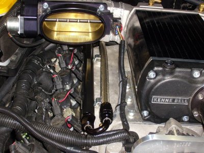

Here's some shots of the progress we made last tonight mounting my shortened (just the drivers side) Aeromotive fuel rails . There's about 1/8" clearance between the end of the rail and the KB bypass actuator. Couldn't go any further, need another foot of submersible hose for the Ford GT fuel pumps install and a 60 degree hose end for the Y block. I'll post more pics on Friday night.

Not even close. I got them to fit just fine on the 2.6 kit. then I upgraded to the Mammoth, No way possible.

I ripped the engine out the day after we installed the Mammoth.
I would take some pics of the mammoth right now but, my car is at the shop.
I had to reuse the factory fuel rails.
sorry I only have one pic of the mammoth but will post many more once the engine is finished.
