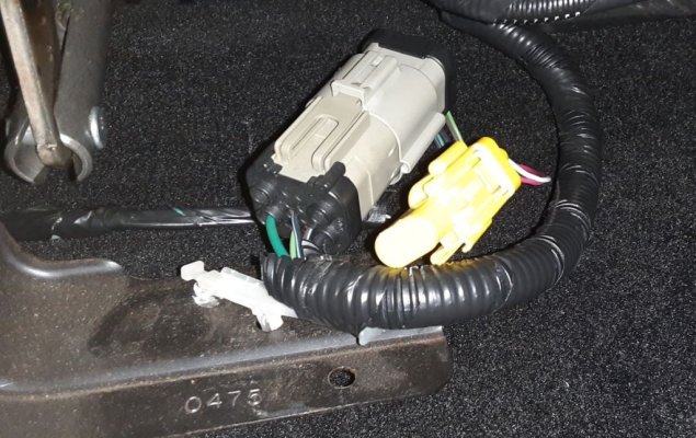

I didnt see any air bag seat label on my seats but the plugs underneath say different, no? But I don't see it on the window sticker either.Window Sticker.jpg

That looks like the same sensor all my Fords have and none have seat air bags. I believe that is for the steering wheel air bag which is connected to the drive seat. Some one on here has to have a wiring diagram and can confirm.

I know for a fact if you cut them off the air bag light shows up on the dash.
When I put Recaro seats I had to remove those. Light came on. There are resistors and plugs to remove the light from coming on.

The old terminating resistor... what is it and what does it do? I have em under both seats.
If an airbag was present, it would have a certain resistance to it which would keep the airbag system happy. Since there is no airbag there would be an open line condition; a terminating resistor is installed to mimic the resistance as if an airbag was present.
