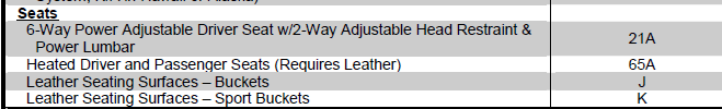

Neither '06 or "07 show an option for power passenger seat, and anyways this extra unused plug is on both sides.
The '07 order guide shows an option for heated seats, the '06 does not.
But the unused plugs are there on my '06 and not the '07.
'06 order guide:
'07 order guide:
If I figure out what they are for, the plugs/wires will be repurposed.

Heated seats and power passenger came together as a single option, and that plug is for neither (they were built into the large green/gray connector).
Not 100% sure but that connector COULD be for the side impact sensor that mounts on the floor tub by the inner rocker. Not sure why your 07 would not have it, but it was a Side Airbag type sensor, not all cars had em
