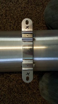

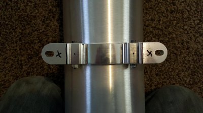

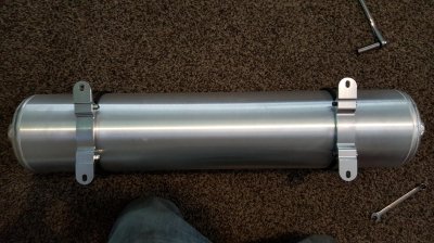

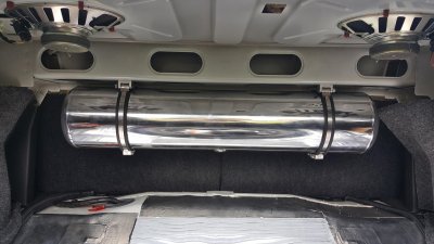

The mounts fit the tank great. The only problem I am seeing is the mounting holes are to wide for the front side of the deck. (Stock mounts are also). I made marks on the mounts where they need cut to fit in that area. Also marks where new holes need to be drilled. The new mounting bolts will need to be counter sunk to clear the strap mount bolts. So I know what I'm doing this evening. Also obviously I need to cut the stock mount brackets off and what the hell I'm going to polish the tank too.

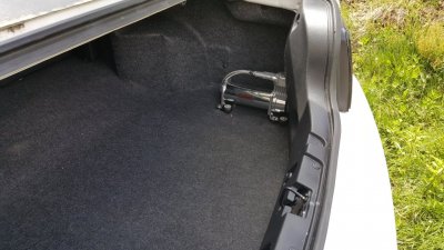

The new mounts look great. I was able to mount mine in the same location with the factory welded on mounts. Then mounted the compressor down below it on the passenger side of the tank right side up. It's all out of the way and i have full use of the trunk. Well most of it:)

I was going to use factory mount brackets but the problem is the tank drain is on the bottom. With using these brackets I can rotate the tank 180 So that the drain stays on the bottom. I got the brackets cut down to proper size and drilled new mounting holes. Will post up pics once I get the tank mounted. Hopefully tomorrow.

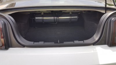

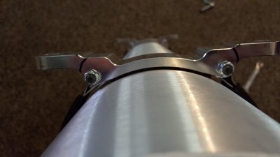

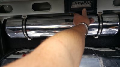

Tank is mounted. The new mounts work perfect. Another pic with reference to where the manifold is going. Have to get bolts to mount it.
Looks great Josh. I can't see any evidence of where you cut the original feet of the tank, how did you do it?
