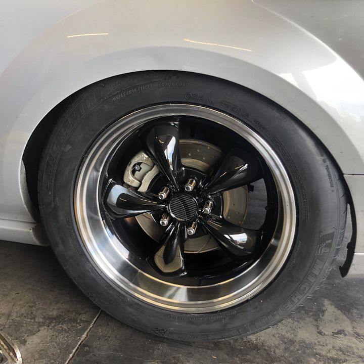

I banged up a rim recently and had to find a couple replacements. I got these. I can't remember how much they were but they weren't very expensive if I remember correctly.

Yes they do and the offset actually pushes the tire out nicely with 255/50/17. I tried to get 2001 rims but ford no longer sold them, I bought the 2003 new and wet sanded the spokes to take the shine off.

Yes they fit, the offset is perfect it pushes the tires out to the edge of the fenders 255/50/17. See if they are still available I love them
