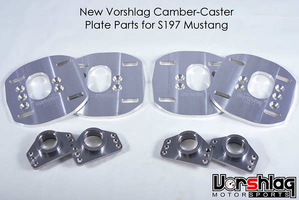

We made our first spherical top mount for the S197 back in 2008 but completely revised it before ever pushing these into production. The Vorshlag S197 design below has been on the market since 2012 and we have sold hundreds of sets to street and race car owners over the past 5 years.

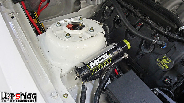

With this design we allow for easy track-side adjustment of camber, offering an additional 2.5 degrees of additional negative camber adjustment. There are also 3 fixed caster settings: stock, +0.5° and +1.0°. There is more adjustment range in this assembly than the stock strut tower opening allows, and some racers open up the tower hole to allow for more usable camber and/or caster range (as shown below).
To adjust camber is easy: jack up the front end, loosen the 4 top nuts, and slide the top of the tire (and strut) inboard or outboard as needed. Align the pointer on the top ring to the 5 reference marks engraved on the plate. Tighten, lower, go race!
The spherical bearing we use is the largest of any camber plate in the industry, and it is a Teflon lined stainless steel high load capacity version. The main plate is high strength aluminum and the bearing holder and top ring are high strength steel, CNC cut to extreme accuracy. The platings and coatings we use are second to none, for outstanding salt corrosion resistance.

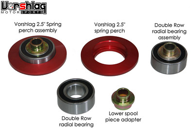

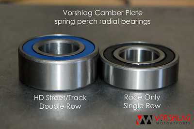

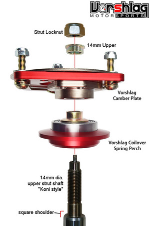

Unlike other designs sold for Mustangs and other cars, our camber plates are modular and come with new upper spring perches. This unique feature allows us to use a sealed, greased, radial ball bearing assembly pressed into these upper perches (shown below) that come in two heights. We can use the shorter version for coilover cars to gain even more suspension travel (5mm) at no extra cost, but our S197 OEM versions need the height of the double row bearing to match the OEM top mount design's stack-up height.
We make the perches to fit the exact OEM diameter and coil shape, or use one of 3 common coilover spring perch diameters (2.25", 60mm or 2.5").
Since 2015, we have CNC machined all of our OEM upper perches for the S197 Mustang to have a perfect fit with the coil shape of all OEM and aftermarket springs made for the S197 chassis. Some have a slight "curl" on the open top end of the spring, so we notch the perches to fit that better than the OEM parts do. The coilover spring perches are color coded to define which size they are, as shown above right.
We do charge more for the OEM spring perch version, but in the picture above it might be obvious why. The coilover spring perches are made from a much smaller quantity of billet aluminum as the S197 OEM version shown at left (8 times the material volume). The OEM version has more machining steps than the coilover versions, with a lengthy process on the CNC mill to cut the "helix" shape, matching the open ended spring shape of the S197. More material + more machining time = more cost.

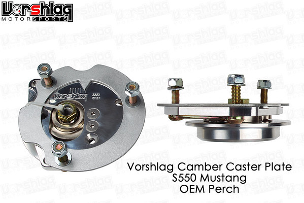

S550 CAMBER PLATE DESIGN
Back in May of 2015 we got our hands on a stock 2015 Mustang GT and quickly designed a camber-caster plate for use with coilovers for this car.
After we measured, designed, programmed, machined, assembled and installed these camber-caster plates for the S550 chassis, as well as designed and installed MCS coilovers, this tester's 6th Gen Mustang was on track 48 hours later and racing in the Optima/USCA series. He has run these plates for 2 seasons now and the parts are still working perfectly.
The Vorshlag S550 camber plate for use with coilover struts has been built for the past year in production and we have had zero problems with the units delivered since then.
Similar to the S197 design, the S550 camber plate has variable camber adjustment that "slides" for another 2.5° of negative camber travel, as well as 2 fixed caster settings (stock and +1.0°). These plates also have more travel built into them than the stock strut tower will allow, but like the S197 design you can modify the tower opening for more usable range.
The S550 camber plate for use with OEM springs (shown above) was a bit trickier to design, and we tackled this in early 2016. The OEM top mount and upper spring perch made for a very short stack-up height, so we had to design some new parts and use a new bearing to make our parts match the factory height. Again, we want to neither raise nor lower a car with our camber plate + perch assembly when the stock springs are used.
