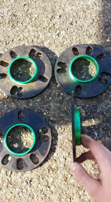

anyone know where I can find a TRUE hubcentric 3-5mm spacer such as the one pictured ? all the listed hubcentric spacers I have found do not have the hubcentric spacer built on which will leave my wheel "floating" once installed. I ask because Im trying to keep my baer gtp 14" front brake kit behind my track only 17x4.5" wheels and after grinding the ribs off the caliper, I am right there.

The 3mm spacer made by H + R is hubcentric, along with their thicker spacers. Fits like a glove..and doesn't budge... that's b4 the wheel is installed.

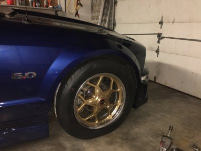

I bought 3” arp studs to be safe and not get kicked off the track, question now is do you have to drill the hole out for the knurl as with past mustangs or do these go in without modification ? I have the frpp (arp) m-1107-a for the front and arp 100-7723 rear which are still 1/2 x 20

I would have purchased the FRPP front hubs with the studs pre installed, they can come loose if you much it up.

2D2F5BC2-68CC-4FF9-8315-ED70C23266E0.jpeg 1E6F1D40-4487-441C-96EB-19B9BED06079.jpeg Ininstalled the front this morning and they went in with no issues fairly easily onto the rears now. Gold plastidipped my drag wheels to make sure I would like the color before powder coating, left the lip polished. Tried blackb1st. I’m really digging this gold though
