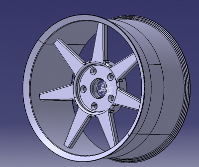

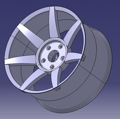

What style are you looking for? I have 18" gt4's. There's the fr500 style, the AMR by american muscle or the SVE by Late model restoration, 2010 gt500 style at AM, 13-14 gt500 style at AM as well as the saleen style and bullitt styles. All of these are less than $200 a piece. I am creating a 7 spoke like the gt350r wheel but 18". If they were 18" then I'd be riding on those already. But I do want come concave to the rears. May buy a set of SVE's rtr style for just another set to have for the hell of it.

I would love a set of those 10th ann wheels for an s197. My pick was between fr500, gt4's, and SVE wheels and barely see any s197's with the gt4's so I got those. But I really like that other pair you posted up! Thanks. No idea when I'll be able to get any of these machined for my car. But the curved 350r style will be the first I do.
