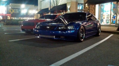

I also conclude that my pickiness might be the reason my last build took me 7 months, although lack of funds, a shitty job, and crazy ex girlfriend might have contributed to that factor. Here is a picture of it anyways beside w3bb3r04 back when I was still in the SN car game.
