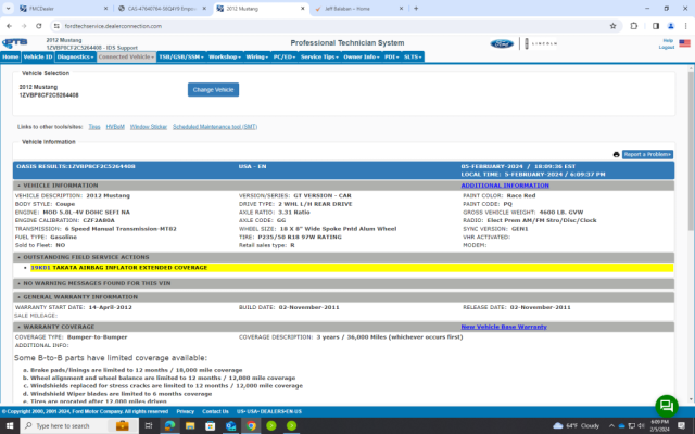

Hi, I have a 2012 gt and I’m trying to figure out what rear end it has. The sticker on the door jam says GG but the the one on the axle says BB. Anybody had this issue before? or am I looking at the wrong sticker in the axle?

GG code is 3.31 gear code. Looks like the Rearend tag is missing with the different plate. Isn’t the BB the axle code length? Not sure,but my 12 gt has the GG code and the diff has 3.31 on the tag hanging from the bolt. Thanks.

The BB code on the axle tube may be coincidental?
Most MT-82 (manual) cars were probably built with the 3.31 axle ratio.
Most 6R80 (automatic) cars were probably built with the 3.15 axle ratio.
This is the list of codes: (found here: https://support.bamaperformance.com/hc/en-us/articles/207043046-11-14-Axle-codes-found-on-door-plate)
BB – 3.73
DD – 3.55
GG – 3.31
YY – 3.15
CC – 2.73
I ordered my 2012 GT with the optional 3.73 and it is indicated on the door tag. I never looked for the tag on the actual differential cover.

Thanks guys! I appreciate the help. I’m just gonna have to get the car on stands and spin the tires. And count how many times the driveshaft spins, before the wheel gets back to its mark. I believe thats the only real way of knowing. I Just thought it was odd that the sticker on the axle said that BB and the one inside the door GG. I was already thinking of swapping them out for some 3:73s. And hopefully I won’t have to.

Did you figure out what you have for a rear axle ratio?
