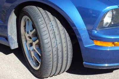

My tire guy got me Toyo T1 sports 275/40/18 for 215.00 each Mounted and Balanced. will see how they work in May @ NJMP. they were a little greasy on test drive today but it was chilly out
