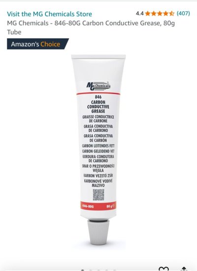

A piece of advice. The S197 is over 20 years old now. Clean up the grounds on the strut tower, behind the engine on the drivers side, and the wiring harness ground points to the passenger side of the radiator. Clean the rust off to get to bare metal. Many people use di-electric grease to protect from further corrosion, but that is actually an insulator. It does not carry a current.
I have found a conductive grease that will allow a current to pass through it. It gets used very sparingly, because it contains carbon black and can be messy. But it’s great for making a solid contact and prevents rust from reforming. Works great on battery terminals too.IMG_0069.jpeg
