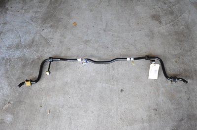

Although I think I will install the Boss Rear Sway Bar.

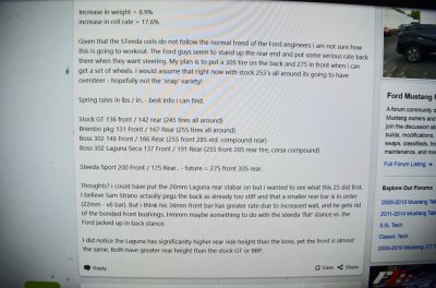

Mustang GT (2011+) Stock: Ft 122 lbs/in Rr 154 lbs/in *
Brembo Stock: Ft 131 Rr167 lbs/in
Boss Stock: Ft 148 Rr 185 lbs/in
Boss LS Stock: Ft 137 Rr 191 lbs/in
Eiback Pro-Kit: Ft 159 Rr 193 lbs/in *
M- 5300-K rate: Ft 173-248 lbs/in – Rears 195-236 lbs/in
Steeda Competition: Ft 225 Rr 185 lbs/in
Steeda Sports: Ft 200 Rr 175 lbs/in
Steeda Boss Springs Ft 225 Rr 195 lbs/in
Steeda Ultra-lite (pn 555-8206) 1.25/1.5 front: 195lb/in / rear: 175lb/in
Per Maximum Motorsports. I had a list from Ford that was on the old BBP Brembo 5.0 website. No idea where it went.

Well I do have a Boss rear sway bar that I have not installed. It's 25mm vs 24 and the LS is 26mm. My installer has been booked for over a month and the nearest Ford Dealer is so booked, they could not install a Ford Motorcraft battery for 2 weeks. Besides the sway bar needs one time bolts and I still have not ordered them. Not sure with 500lbs springs around, any of the stock type spring really seems not to make much of a difference.
