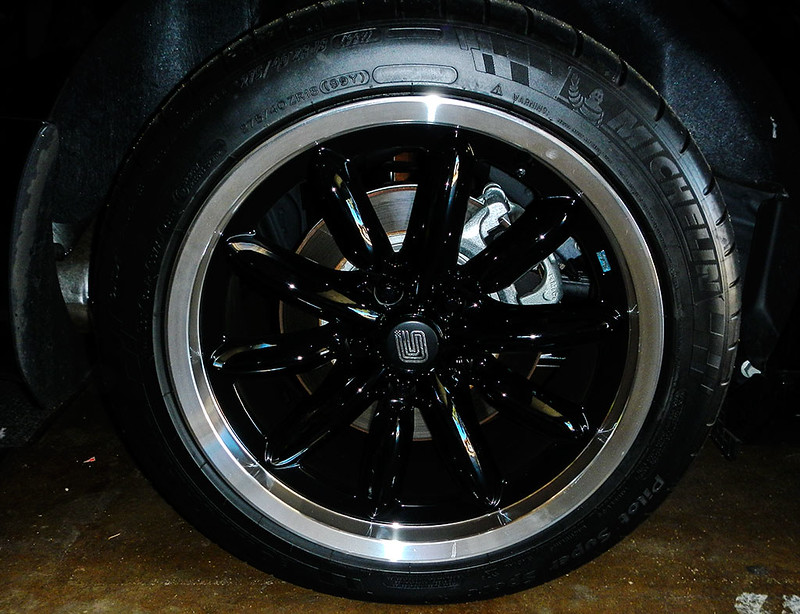

These are Saleen Parnelli Jones Edition wheels, 19x9 front 30mm, 19x10 rear 50mm, with the Super Sports at 275-35 front, 285-35 rear:

Hey Frank, those Saleen Parnelli wheels are f'n sexy!!!! I really dig those, not sure if I've ever seen them. Sexy!!!
You've probably seen the Parnelli wheels on the orange Parnelli Mustangs, but painted in their standard silver. Someone had these powder coated before selling them to me.
Thanks Frank. I recognize them now. They look sexy in black tho. I saw one at a car show in NY, and I believe there were a few at Carlisle or American a Muscle. I forget which one. I think I dig them better than the Shelby wheels.
