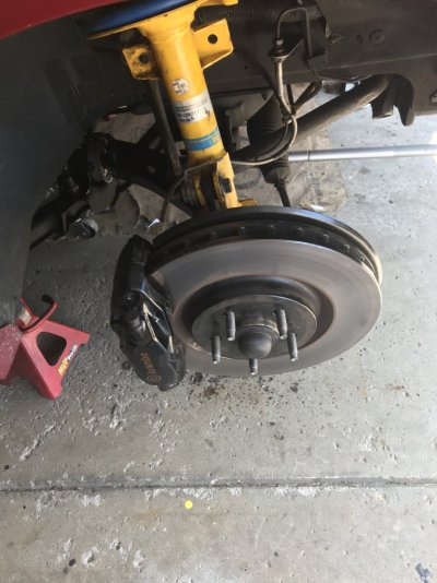

I have the 4 piston up front with the 13/14 rear brakes and I have not noticed any ill braking effects from this setup. To be fair, my car is a streetcar so I don’t push it to the very limit on public roads, but during spirited driving it hasn’t been a problem on my car.

I did the exact set up about 5 yrs ago (Front/Back) and had no problems whatsoever. The stopping power increased by about 20% and they work like normal OEM. You will need at least 18" wheels.

No need to change anything in the rear. Many of us including me run the Brembo's up front with stock rears and everything works fine. Only upgrade to recommend for the rear is steel braided brake lines. Otherwise good to go. Cheapest route for the Brembo's is to purchase new rotors/pads; and rebuilt calipers for a 2008 - 10 GT500 from an auto parts store (I got mine at O'Reilly's). Ran about $400 for everything (expect costs to be somewhat higher now). Mine came in gloss black powdercoat and have worked flawlessly since installation. You can get brembo stickers on feebay.
