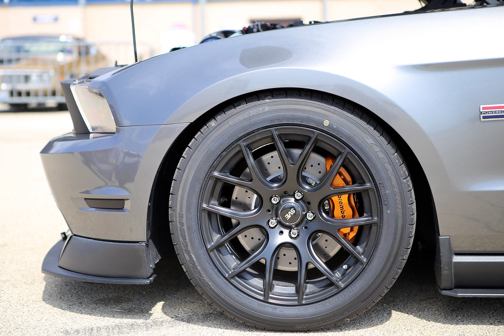

Finally installed. I was gonna install extended studs with them but with my little hammer, it wasn't happening. So here are some pictures.
** I noticed that the brake fluid was eating up the clear coat. Glossy coat is now kinda dull where it got some fluid. So yea... VHT high temp caliper paint/engine paint aren't really brake fluid resistance even after proper curing. If you wanna do it right, I guess powder coating is the only way. I'm not getting any fluid leak so this will be ok for now.
No more ricer shit.
14" rotors and brembos fit nicely behind 18" SVEs.
Burnt copper stands out nicely but not too flashy.

Really nice job!!
I'm sorry you got hosed on the rebuild kit though.
I happen to live near a large brake re-manufacturer. I was able to pick up all the parts to rebuild mine for about 35 bucks, boots, o rings, everything. Finding part#'s is very hard since there are so many different types of brembos. You almost have to just match them up.
Again, great job! Looks great.

Thanks guys. Yea the $120 rebuilding kit is just ridiculous. I think if I had done more research I could probably find them for much cheaper but I was impatient because I really wanted to get these thing done and installed.
Paint and clear coat is holding up really well so far. We have had snow, more salts on the road since I put these on but it still looks good as new.

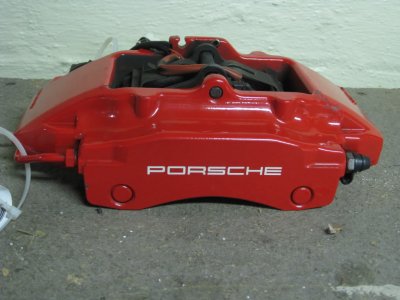

They're actually Ford GT calipers. Which are also Aston Martin calipers. You can see the Aston "Wings" cast into them. They're a really nice monoblock caliper. I've been trying to get my hands on the brackets needed to run them on an S197, but nobody will sell them separate from the kit.
They are actually 1998-up Porsche 996 Calipers. Aston reuses the NOS from the same manufacturer.
