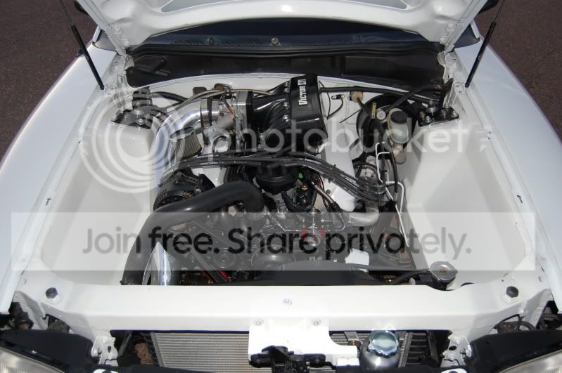

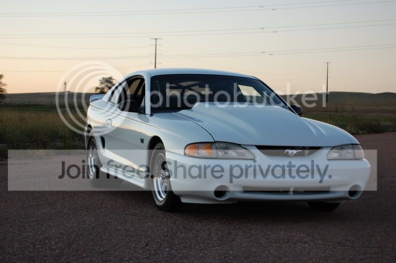

Here's my last car and motivation. Started with a bone stock 95 GT. The chassis build went a little far and I let it go to start our family. Other than the cage and no a/c, the Shelby will end up similar

thanks. it was my baby. unfortunately the guy I sold it to put a BBC in it, cut holes in the bumper and transitioned it into a full drag car.
