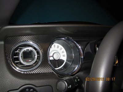

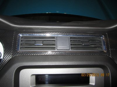

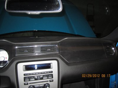

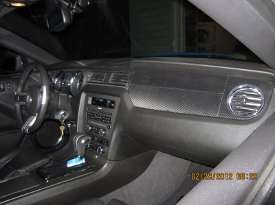

i got bored at work today and decided the car needed a change... it had the standard brushed aluminum dash... im sure i will get mixed reviews but i like how it turned out.

all the chrome bezels snap out and i just unhooked the battery and took out the airbag.. the outside cover just pops off. Makes the job ALOT easier. took my time and took me about an hour... Since i do window tinting i used the heat gun to get the vinyl warm enough to stretch it around the corners and to help anchor it down. the hardest part is keeping the grain of the vinyl all the same.
