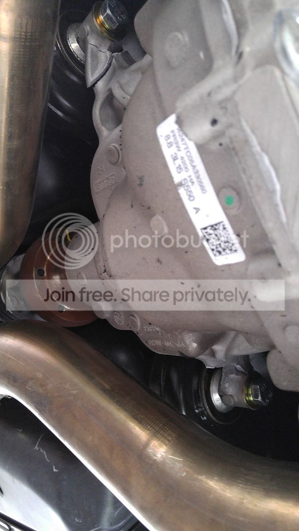

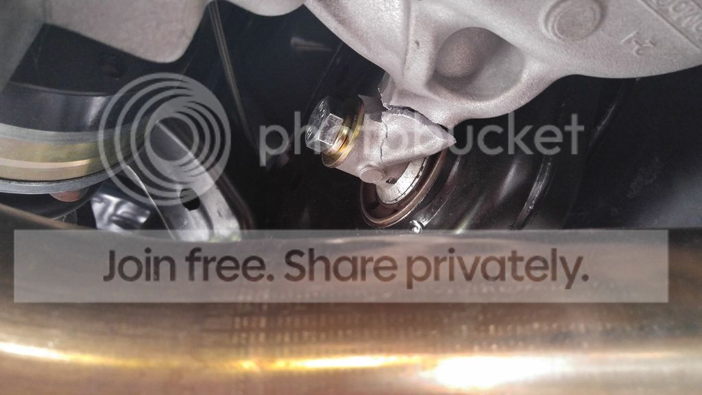

I had a long weekend of breaking parts at the track this weekend at NMRA Bowling Green World Finals.

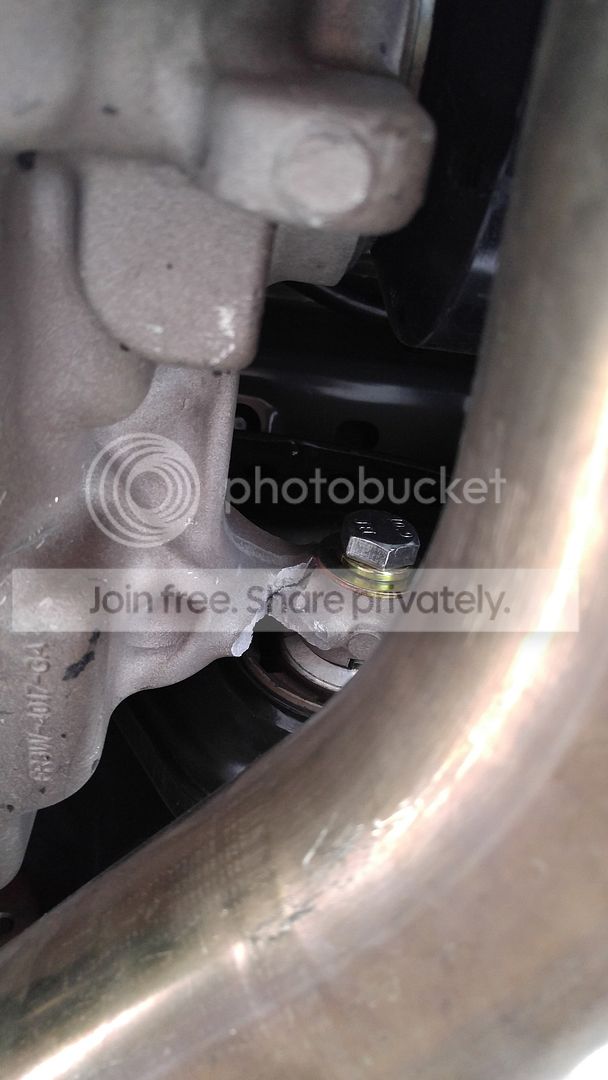

First pass off the trailer - heard a very loud snap right on the launch. I snapped the ears right off the diff housing, on the front side.

It did cut a 1.40 sixty on the pass that destroyed the diff.
It traps 145-146 range at 3850lbs.
So it makes some power.
Auto, stock converter, stock trans, 3.15 gear.

What do you want to bet Kelly is already hard at the drawing board designing a steel wrap around support bracket to reinforce those cast iron mounting tabs?
Ummmmmm.....
Are you tapped into my phone? I've been texting my product design engineer for the past hour brainstorming a brace to make up before this weekends race.

Can't you just run one of the cast iron housings? Seems like that would be the easiest solution.
