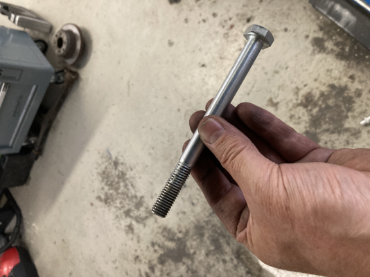

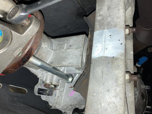

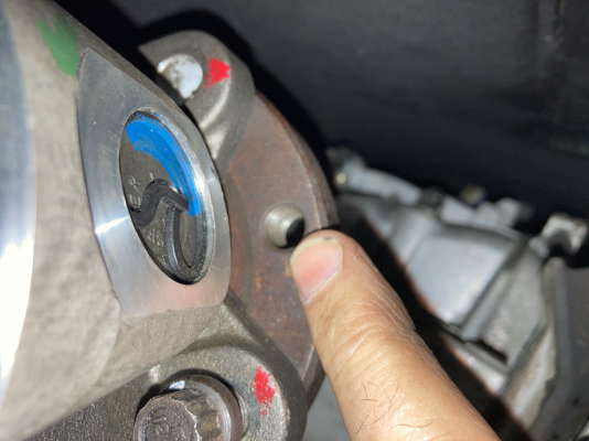

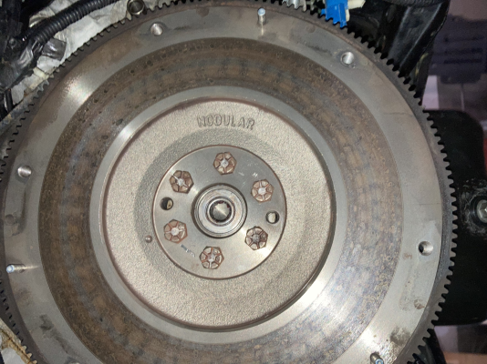

@ all on the first three pics you can see a helpful item to block the DS from turning.. a 12x1.5mm Screw. I screw this his bolt into one of the treads on output shaft of the tranny..

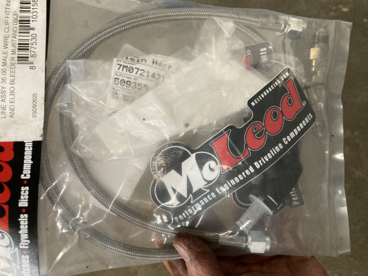

the forth pic shows the MC Leod kit, I purchased... this one has a bleeder...

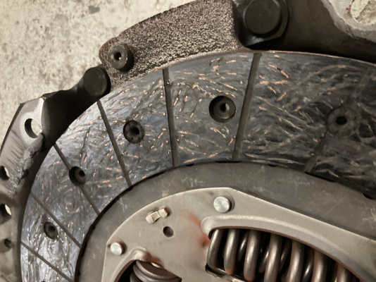

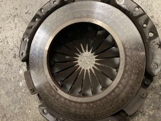

the last pics show the old clutch kit... still ok ( my opinion ) the car made 70 k mls with the clutch
( this is the clutch that the factory installed )

I currently have an 05’ auto GT and 87’ 5 spd 5.0L, but most of my mustangs have been stick, so I have done many TOB, clutch & PP in my time. I highly recommend resurfacing that flywheel or buying a SFI rated one. Don’t forget the crank pilot bushing which I prefer rollerized.
Others will chime in on the TOB spacer/washer. That’s critical in these newer Mustangs.

Id put that clutch back in, unless it had a 'heavy' pedal.
i would agree as the rivets have quite a bit of material around them yet , (altho the rivet all the way to the right in the pic looks worn down but could be the angle of the pic since the others look meaty yet)
