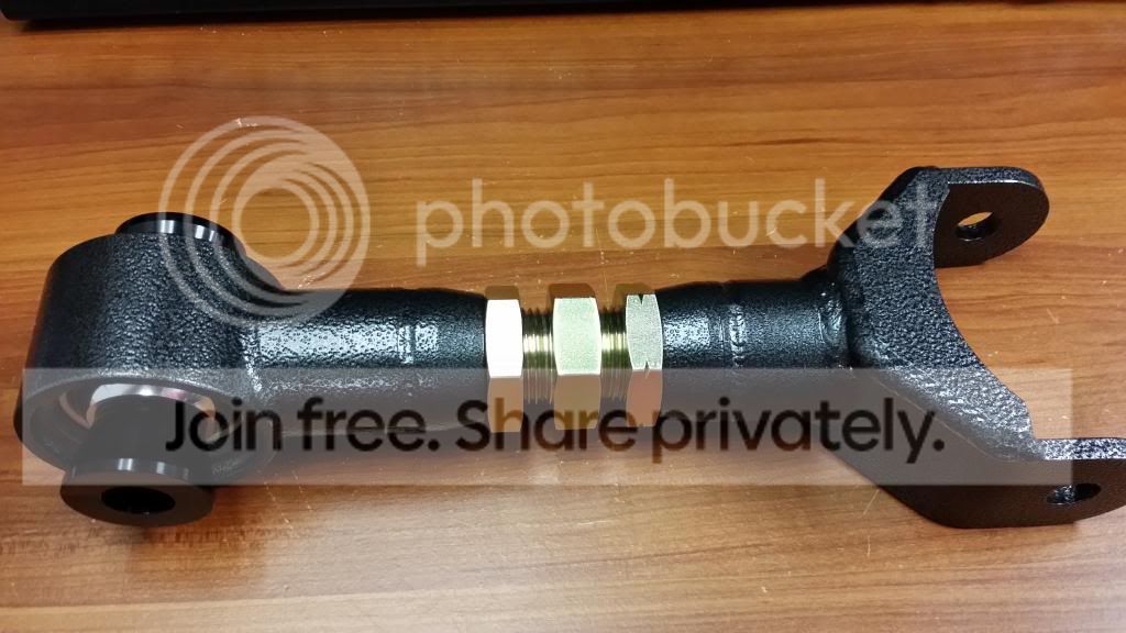

CobraRed
Creator of Tools
Oct 8, 2014
281
LA
This should help:
For some reason I didn't think these were this big. SN95 habits I guess.
claudermilk
Jul 12, 2012
1,840
SoCal
Damn that picture puts some scale on that part. I didn't think it was that big either. Massive, super-beefy part there.

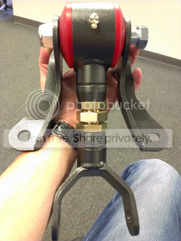

BMR Tech
Traction Vendor
Dec 15, 2009
4,863
13
Tampa, FL
I hope OP doesn't mind, but here is a good idea. I am a decent sized dude too.
Of course, he is going with the UTCA033 set-up...so it won't look quite as ginormous. (pieces pictured are a custom 9" version we build for the Shelby S1000)
