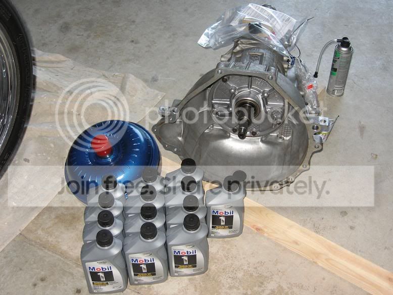

what 4r swap did u buy or build?
Car came with a 4R. I rebuilt it (since the 1-2 accumulator spring/piston gets cooked overtime) and decided to sorta go all out with hardened input/intermediate shafts, a combo of a shift kit and the Jerry mod, a spec-rite then later 4C converter, stacked plate trans cooler and I forget the rest of the components that made up the build. The trans is in a turbo 04 cobra in Florida now.
