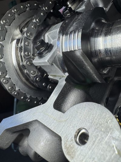

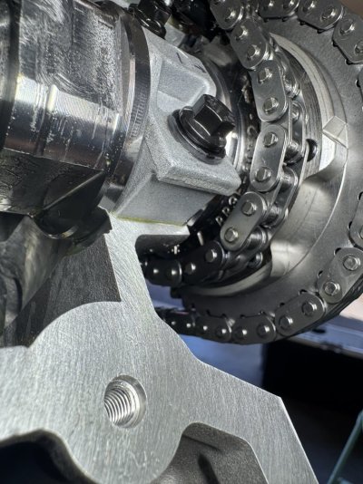

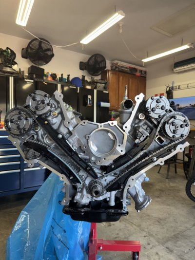

Tore it apart because I second guessed myself. I bought all new ARP hardware for the cam caps and all the phaser stuff as well since I needed to replace them anyways. I hate tty bolts! This time I’m posting pics of timing to verify. I still couldn’t “seat the cams” nicely in the caps. They stuck up on one end, more so on the drivers side for some reason. Key way was at 9 o’clock for driver side and 12 for passenger side. Please look at pics and provide feedback.
Drivers side marks below.
